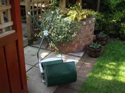

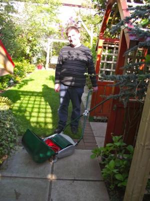

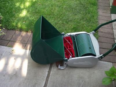

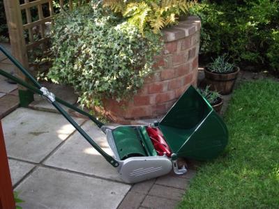

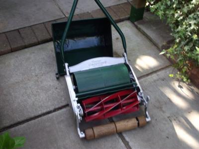

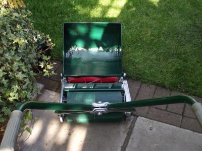

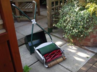

Photos of the ransomes ajax at last.
At last, have finally figured out this picture lark. well... As Promised... Photos.....
first shot of my ransomes ajax MK5
closer detail
with box fitted
side on view
me and my old beauty
other side?
After First Mow!!!!!!!
