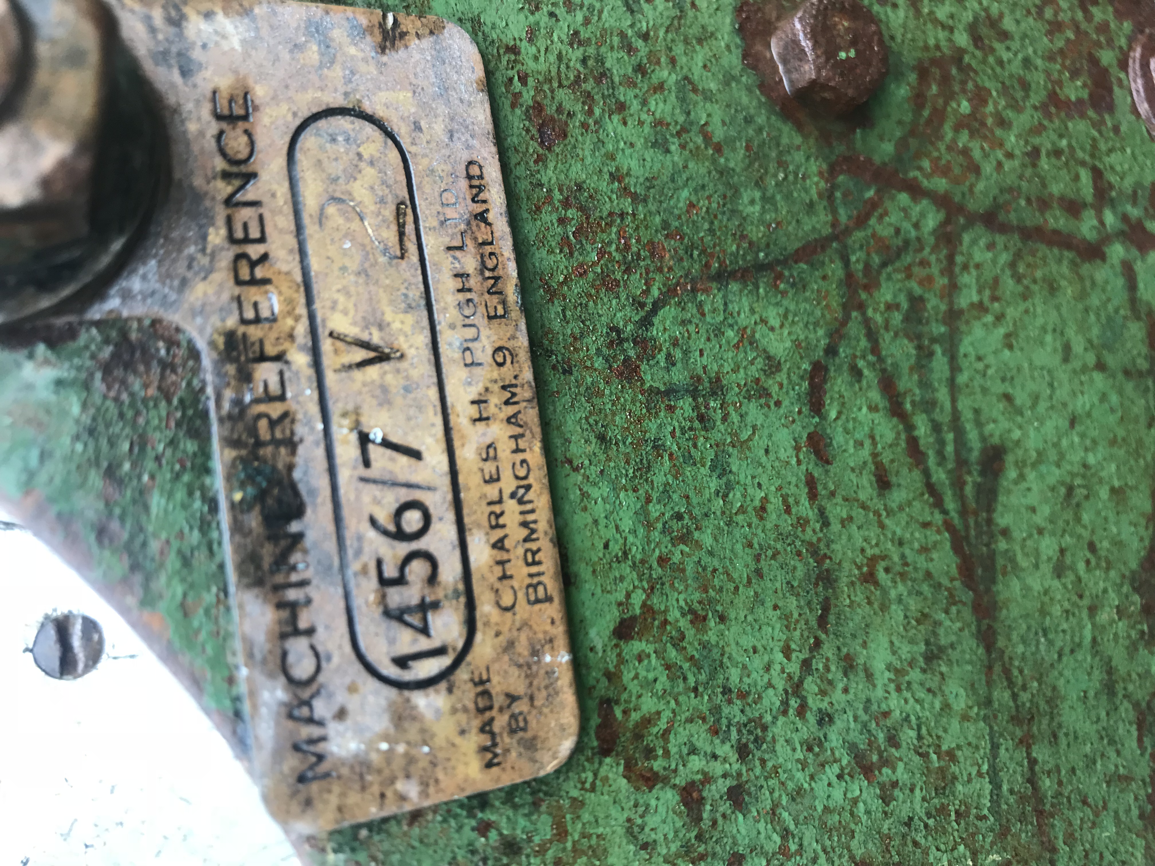

Been given this mower from my uncle just need to identify the engine so I can source spares etc for a refurb. Any workshop manuals available for this
regards Alistair

A nice original 1956 14” two
A nice original 1956 14” two stroke. If it’s going to be a working machine, give it a set of front rollers, a regrind and the oily rag treatment and stay away from the paint pot.

Thanks for the reply . Yes it
Thanks for the reply . Yes it has wooden handles and dog clutch but hasn’t the front rollers and my uncle still looking for the grass box but fears with it being on a farm somebody has helped themselves to it . It was running when it was put away in the shed so hopefully won’t take much to get going. Ive already done the carb which was all glued up. Next I need to acquire a new ht lead with the fitting that goes into the flywheel.
And yes I’m keeping it totally original and no paint .
